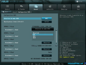

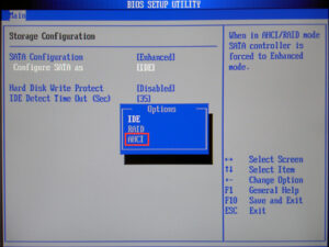

  • Enable AHCI mode
    Enter the BIOS settings interface. Find the SATA Configuration related option and set it to AHCI mode. Please note that different motherboard manufacturers will have different BIOS interfaces and options. Here are some reference demonstrations:
